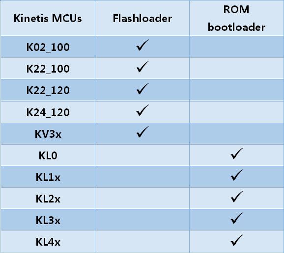

       KBOOT provides two ways for implementing, ROM bootloader and Flash bootloader, ROM bootloader is only applicable to the Kinetis MCUs which already integrate the ROM and the KBOOT application reside in it. So the ROM bootloader is available during the entire product life cycle.  The opposite side, the Kinetis MCUs without ROM can be programmed through the Flash bootloader. For the Flash bootloader, it runs into RAM and receive the application image, after it program the image into the Flash completely, then it Flash bootloader will go to die, in another word, it will no longer be available again. Table 1 shows supported Kinetis MCUs.
Table 1 Support Kinetis Devices

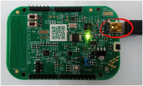

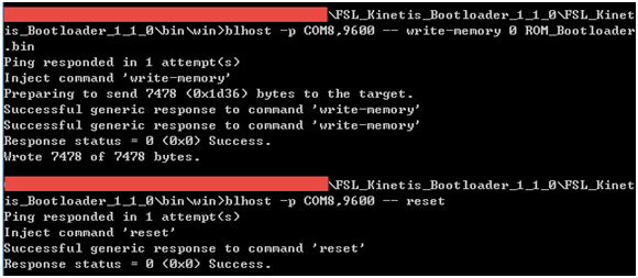

    However I’ve encountered an issue when I tried to use the blhost application to communicate the FRDM-KL03Z (Fig1), it still couldn’t establish a connection, as Fig 2 shows.
Fig 1
Fig 2
  • Workaround

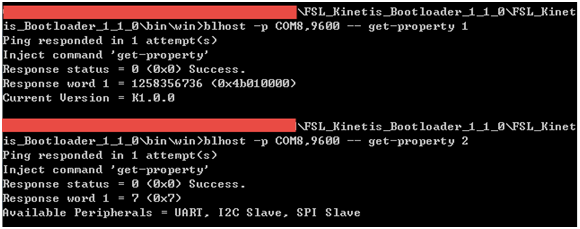

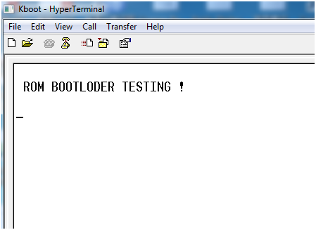

      The issue will disappear after choose a lower baud rate when blhost application communicate with the FRDM-KL03Z board after I validated. And the whole procedure to program application code as follow.
      1. Establishes the connection
       2. Erases the entire flash array
      3. Programs the application code
      4. Application code runs
