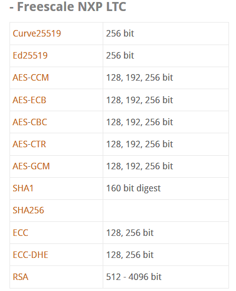

EugeneHiihtaja
Senior Contributor I
Hi Mark !
 If i enable this flag, some operations are routed to LTC, but it cause BusFault. By checking dependencies and reading RM I have got impression
that LTC is not able to accelerate P-521 due natural HW limitations.
I'm not able to make SW implementation to work yet. P-384 , by using SW,  work fine but it 10x slowly than HW one.
So even it will work, it might be so slow than it dosn't have sense to any real application.
But I need confirmation for my investigations for be sure if it really so.
By the way, is any schedule available for new K82 SDK where mbedTLS 2.7.5 and freeRTOS 10.1.0 will be taken in ?
Eugene

mjbcswitzerland
Specialist V
Eugene
This is what WolfSSL has LTC support for:
If it doesn't list the support that you need it is very probably that it is not possible in HW with the controller.
Mark
