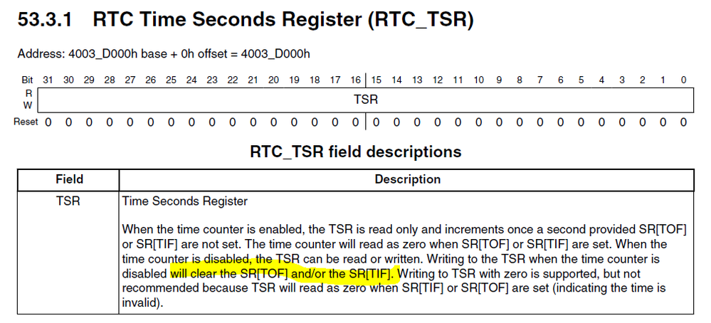

mjbcswitzerland
Specialist V
Eugene
The flag is cleared when the timer counter is disabled and something is written to RTC_TSR.
The TIF flag is also explained in the user's manual:
however don't get fooled by the note about it being set on a software reset since this actually means the "RTC software reset" command (via RTC_CR) and not a general processor reset.
Mark

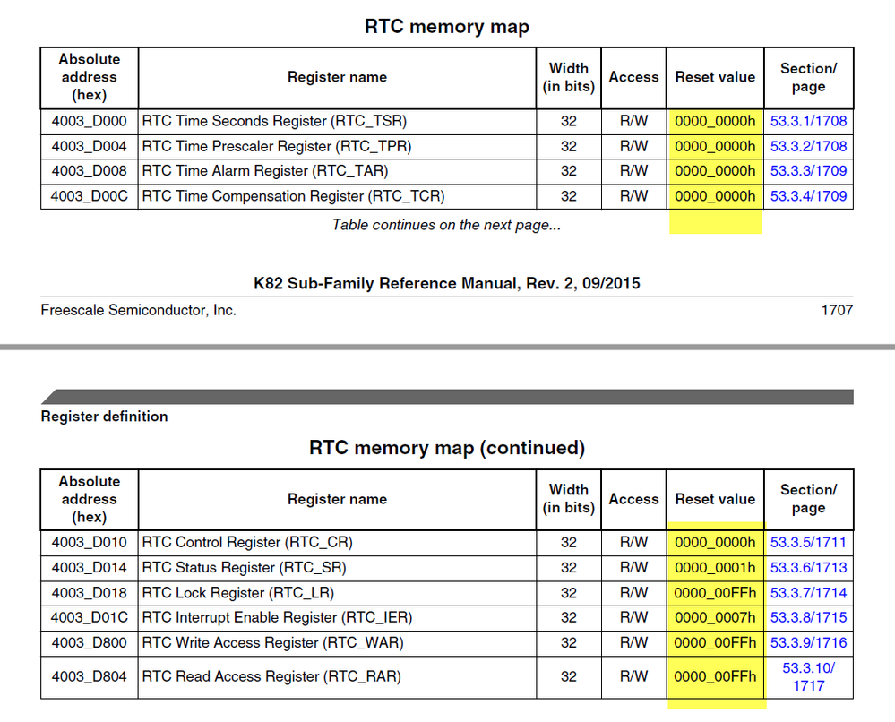

kerryzhou
Hi Eugene,
     Do you just want to check whether RTC is initialized?
     If yes, you just need to compare the register with the reset value.
Actually, if the RTC is configured, and want the RTC to run, you need to enable the RTC_CR_OSCE.

EugeneHiihtaja
Senior Contributor I
Hi Kerry !
So initialisation flow after  HW/SW reboot can be like this:
- enable RTC clock source
- read few RTC registers  or one for example RTC control register
- if control register has default value -> reinitialize RTC according SDK example ( full flow )
- clean all flags in status register if any
- RTC is continue to run as usually.
But what about Time Invalid flag ?
Time Invalid Flag
The time invalid flag is set on VBAT POR or software reset. The TSR and TPR do not increment and read
as zero when this bit is set. This bit is cleared by writing the TSR register when the time counter is
disabled.
It should indicate software reset and etc.

kerryzhou
Hi Eugene,
    After reset, the TIF in default is 1, it means the time is invalid.
    If you want to enable the time valid, you must write 1 to this bit.
   After you initialize the RTC, you also need to start timer, then the RTC will run:
 RTC_StartTimer(RTC);
  The flow, please refer to the SDK rtc project:
RTC_Init();
RTC_SetClockSource(RTC);
RTC_StopTimer(RTC);
RTC_SetDatetime(RTC, &date);
If you want to use interrupt, you also need to enable the interrupt bit, and the NVIC RTC IRQ.
Wish it helps you!
