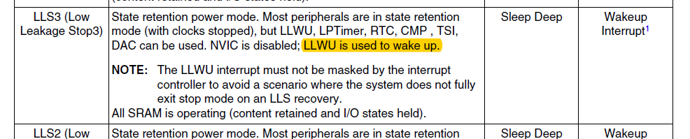

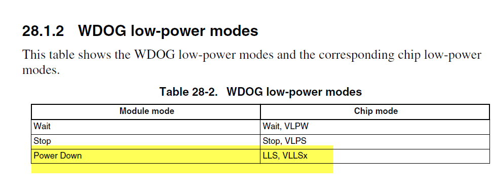

Hi Eugene,
   Yes, you understand the WDOG in the wrong way, please check these information:
When you enter the LLS3 mode, you need to use the LLWU module to wake it.
Wish it helps you!
Kerry
