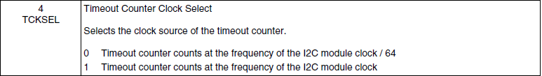

From hardware perspective, we need to configure below registers
I2Cx_SMB[TCKSEL] is used to select the clock source of the time out counter.
For example, if timeout is 30ms, TCKSEL=0, bus clock is 25M

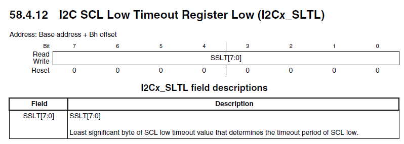

  I2C0_SLTL = I2C_SLTL_SSLT(0xC7);       /* I2C0_SLTL: SSLT=0xC7 */
  I2C0_SLTH: SSLT=0x2D                           /* Set SCL low timeout register low */
  I2C0_SLTH = I2C_SLTH_SSLT(0x2D);     /* Set SCL low timeout register high */
