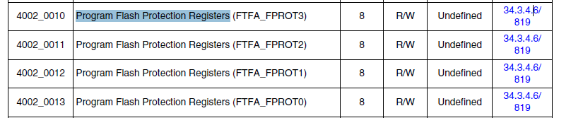

Can it be so that those API is not work properly ?
if (config->ftfxConfig[0].flashDesc.feature.hasProtControl)
if (config->ftfxConfig[0].flashDesc.feature.ProtRegBits >= 32)
*kFPROTL = protectStatus->protl;
if (protectStatus->protl != *kFPROTL)
return kStatus_FTFx_CommandFailure;
ProtRegBits need to be set to 32 but no any code in SDK is not exists to do it ? It has value 0 ?

    Actually, FLASH_PflashSetProtection API is used to set the protection bit, write the Program Flash Protection Registers
It is 4Bytes, just 32bit.
ProtRegBits can be set by yourself in the code, you totally can define it.
Wish it helps you!

Yes, I have modified it by myself. But it is clear defect in SDK and have sense to improve it at some point.

   This variable normally need to be configured in the main code before you call the according API, so this point is not the SDK bug.
   Any way, next time, when the SDK do the improvement, I will suggest it.
