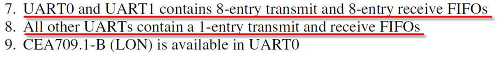

Hi all,
I'm working on K70 microcontroller.
I've successfully implemented uart driver without hardware fifo. ( 8-E-1 38400 baud rate)
Receive in Interrupt mode and Transmit in Polling mode.
Now I want to use hardware fifo. However after enabling hardware fifo its not working, not going in ISR routine.
below is my code. Please correct me where I'm doing wrong

Hi Aseem,
According the  standard feature of UART which is describled in Chart 3 Chip Cofigruation of reference manual. The UART2 contain a 1-entry transmit and receive FIFOs(Fig 1) and the proper value be set in the RXWATER muste be less than the size of the Receive buffer/FIFO size as indicated by PFIFO[RXFIFOSIZE] and PFIFO[RXFE] and greater than 0(Fig 2). So I think you should check the code
UART2->RWFIFO = UART_RWFIFO_RXWATER(2); /* with fifo */ which set the size of FIFO is 2.
                                                                        Fig 1
                                                                         Fig 2
