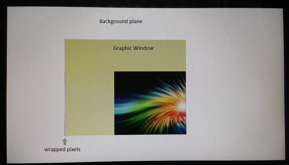

Hello everybody,
I've tried to use graphic window in the LCD controller built in the K70, but I have some troubles.
Screen in the graphic window is shifted by 1px (horizontally) and the last pixel of each line wrap around GW and appears at the start of the line.
Picture explains what I mean:
This problem doesn't depend on the size and position of the GW. It is not possible to eliminate it by address offset.
I use 800x480 24BPP display, but I've tested at 480x272 24 BPP display - same problem.
Here is my initialization of the LCDC, near standard code from Freescale examples:

Hello Slawek,
Your configurations seems to be Ok, please double check that the macros GW_XSIZE, GW_YSIZE and PAGE_XSIZE are correct. Also, please verify that the registers LCDC_LGWPR, LCDC_LGWVPWR and LCDC_LGWSR have the desired values.
What do you mean with "It is not possible to eliminate it by address offset"? I think that you are referring to the graphic window's position, please try to change the image's position inside the graphic window without modifying the graphic window's configuration.
Please let me know if this solves the issue.
