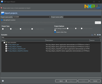

I am using FRDM-K66F and trying to build HTTP server with Digest Authentication.
Could anybody let me know if there is any sample to use based MCUXpresso IDE?
Christie
2,359 Views
Pablo_Ramos
Hi @a8Chcx,
The HTTP server examples based on MCUXpresso IDE for Kinetis K66 can be found in the SDK.
You can access these examples by importing the SDK examples and searching for http.

Pablo_Ramos
Hi @a8Chcx.,
I apologize for any inconvenience this may cause, but we do not have examples of an HTTP server with digest authentication for Kinetis K66.
My recommendation would be to start with the httpsrv_freertos example. You can find APIs in the httpsrv folder that can assist with the implementation.
Please note that the implementation will need to be done on your end.
