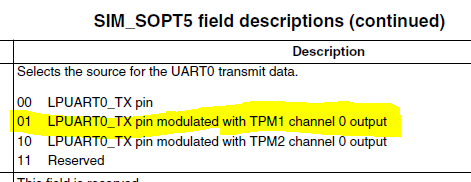

If I use TPM1_CH0 to multiplex LPUART0 Tx it works as expected:
Here I use the TPM1_CH0 output to generate an accurate break just before a Tx frame (SIM_SOPT5 has 0x00010000 set to select this).

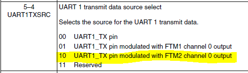

When I did the same on UART1 with FTM2_CH0 there was no effect when SIM_SOPT5 has 0x00000020 set.

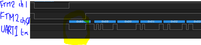

However, by chance, I found that there is an effect but it depends on "both" FTM2_CH0 AND FTM2_CH1!
The modulation on UART1 Tx is only present when FTM2_CH0 is low AND FTM2_CH1 is high!

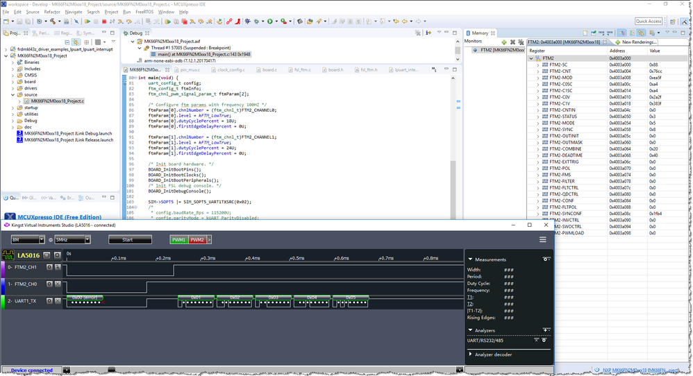

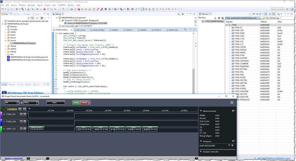

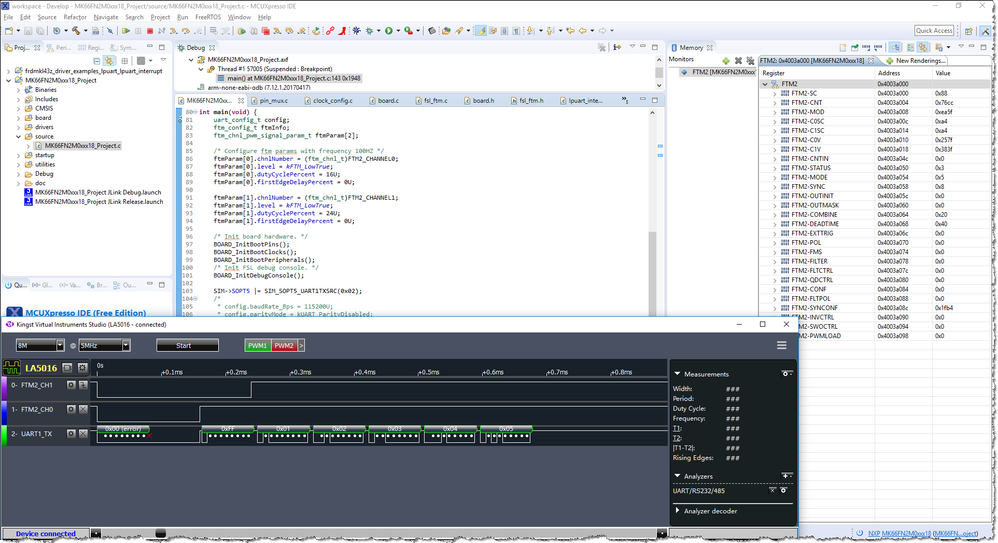

I test the attached project on FRDM-K66F board.
The FTM2_CH0 can modulate UART1_TX when FTM2_CH1 is low.
You can see the images: when I increase the duty of FTM2_CH0 during FTM2_CH1 is low, UART1_TX can be modulated by FTM2_CH0.
The MaskSet of K66 on FRDM-K66F is 0N65N.
Robin
