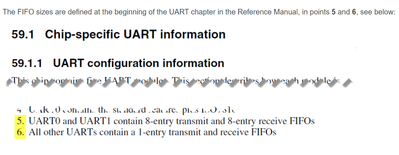

mdrasool_yadwad
I want to increase  the size of the UART fifos. Can i have the option of doing it.
2,968 Views
danielchen
Hi @mdrasool_yadwad
Please note that there isn't any way to change the size of the FIFOs. The sizes are read only.
