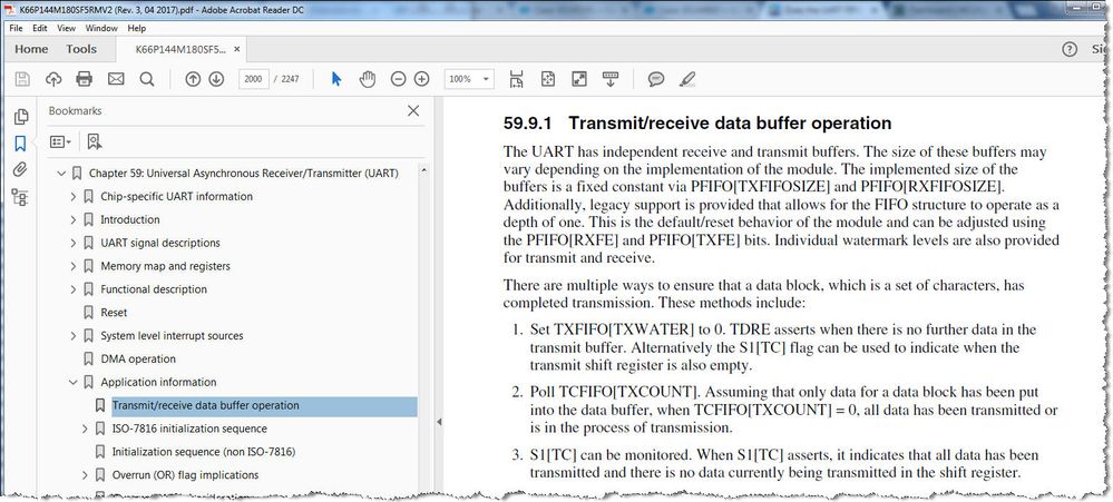

leerollick
Does the UART FIFO require interrupts to be enabled?
1,491 Views
Robin_Shen
no. But it would be better to enable interrupt when using FIFO.

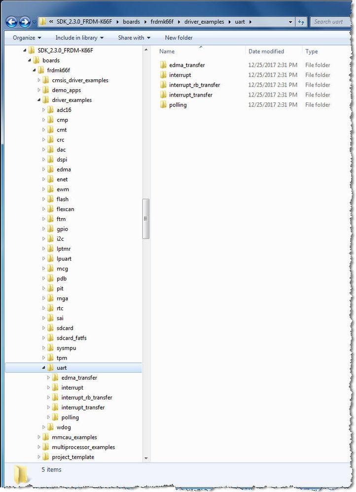

You can refer the examples in SDK_2.3.0_FRDM-K66F.
