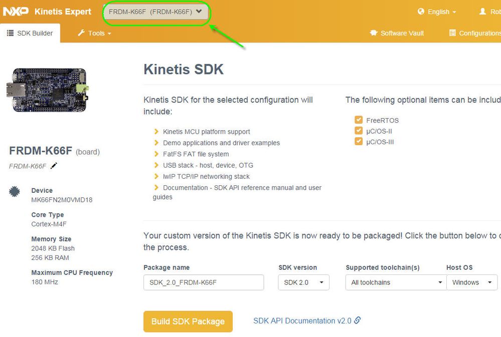

If you are using the FRDM-K66F evaluation board, you can download the Kinetis SDK v2 & v1.3 (REV 2.0).
Then select and download the "SDK_2.0_FRDM-K66F" .

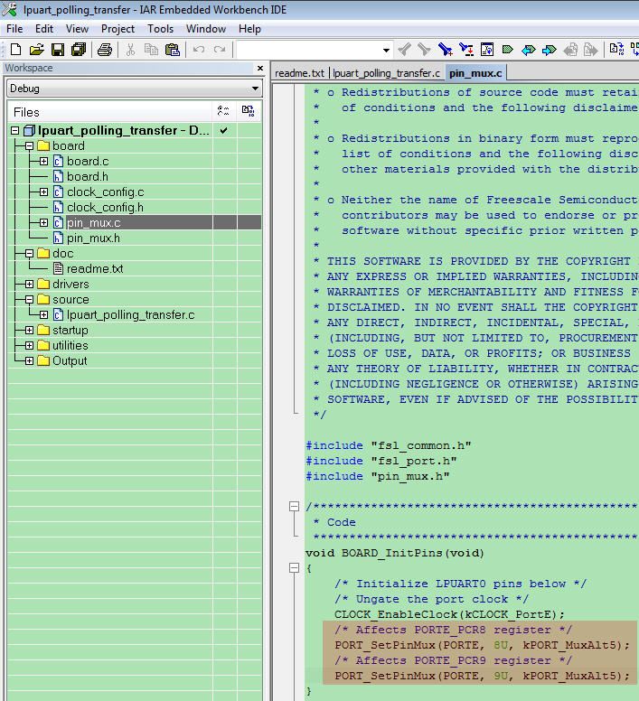

You can find the LPUART driver_examples after installed it, such as in "E:\SDK_2.0_FRDM-K66F\boards\frdmk66f\driver_examples\lpuart".
These driver_examples using the PTE8 and PTE9 as the LPUART0 pins.(See the BOARD_InitPins function)
You can have a test first and then change these Pins.
