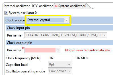

We were able to get the PHY PLL to lock by specifying that the external oscillator was a crystal.  This is shown below in Processor Expert:
This will set the EREFS field of the MCG_C2 register to a 1.  This is a problem as we don't actually have a crystal and we are using the output pin as GPIO.
Is there a way to get the PHY PLL to lock without setting the EREFS field?

sam_
