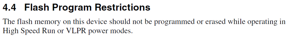

I would like to know what is the clocking requirements for the K65 when using 180MHz and writing to the flash?
I can't seem to find any mention in the documentation but if I try write to the flash I get a kStatus_FLASH_AccessError. I have tried to slow the core clock down by changing SIM->CLKDIV1 (OUTDIV1, OUTDIV2, OUTDIV3 & OUTDIV4) and I still get the access error even though the core clock is now 45MHz and the other clocks are divided appropriately.

The HIGH SPEED RUN mode state will logically block Flash programming - that means that there is presumably a digital connection from the RUN state output to the Flash module controlling this. It blocks programming irrespective of the actual speed of operation.
If you don't set HIGH SPEED RUN mode but just RUN mode instead you can also probably work at 180MHz and the Flash programming indeed operates. This will however be operating out of specification so should not be done for anything more that testing or geek-projects where over-clocking may be considered 'cool'.
For applications where the HIGH SPEED RUN mode restrictions are not acceptable the device should be used as a fully-functional 120MHz device instead in the default RUN mode.

Just an update on other points I found relating to the HSRUN Flash access:
32.1.3 Glossary
HSRUN — An MCU power mode enabling high-speed access to the memory resources
in the FTFE module. The user has no access to the Flash command set when the MCU is
in HSRUN mode.
32.4.10.1 Command Write Sequence
Attempts to launch an FTFE command in HSRUN mode will be trapped with the ACCERR flag being set.
Charles

    Just as Mark has replied, you can find in the K65 RM, chapter 8.7 Flash Program Restrictions.
    HRUN can't do programmed or erased, please change the mode to RUN mode, then you can do the flash operation.
