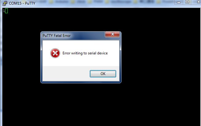

Hi, I am using USB CDC Virtual COM Demo(FreeRTOS) and my development environment is K64F12+KDS3.0+KSDK1.2.0 without PE. I want try to change the FlexBus clock (CLKOUT) according to PC serial port input. However, when I change the value of ''.vdiv0'' and re-initial the clock again, the virtual serial port cannot find any more and nothing can be wrriten to the port
the code is shown following:

if BOARD_ClockInit30M() is not included in the case statement, the LED can be toggled correctly and serial port is normal. However, when the BOARD_ClockInit30M() is included in the case statement, the serial port can only be inputed once and then when I input again, error message will appear and the serial port cannot be opened anymore.
Could anybody can help me about this? I suppose it may because I re-initial the clock but I don't know how to fix it.
Many thanks!

Does the clock is changed correctly? If you are debugging, can you continue debugging your application and the terminal is the only thing that crashes?
Due to you are changing the system clock, the bus clock, the flexbus clock and the flash clock, and the USB and UART are depending on those clocks you need to de-initialize the modules, change the clock frequency and then initialize them again.
Earl.

EarlOrlando
Senior Contributor II
Just to be sure, the demo that you are modifying is the one located at C:\Freescale\KSDK_1.2.0\examples\frdmk64f\demo_apps\usb\device\cdc\virtual_com\freertos\kds?
I am almost sure that the problem is that you are changing the USB module frequency. Remember that it must be always 48 MHz. Please be sure that the clock source for that module is not the PLL (because you are changing the VDIV value which changes the MCGPLLCLK frequency), it is not recommended to use the FLL because it is not very accurate so the solution is to use the USB_CLKIN or the IRC48MCLK lines to feed your USB module.
Earl.

EarlOrlando
Hi Gloria,
Another way to change the core/bus/flexbus/flash clocks without change the PLL frequency is modifying the SIM_CLKDIV1[OUTDIVx] register. You could try that. This is done by changing the fields outdivx in the simConfig field in the clock_manager_user_config_t structure and then calling the function CLOCK_SYS_SetConfiguration.
