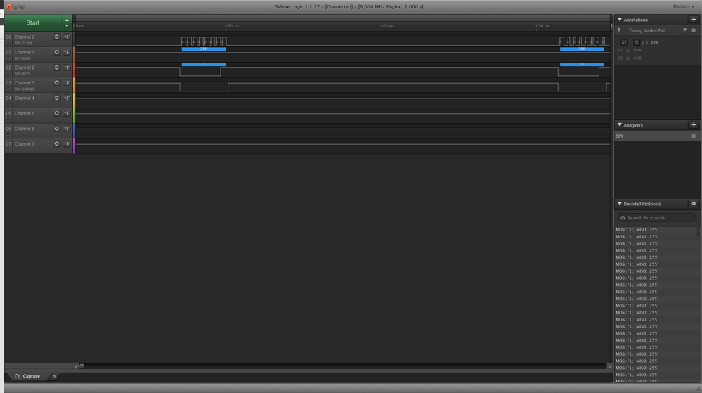

Hi I am newbie for embeded programming and ı have problem with spi I am trying to write basic spi to see going datas  with logic analyzer but as ı see data not going. if you can help me where is the problem ı will  be happy.

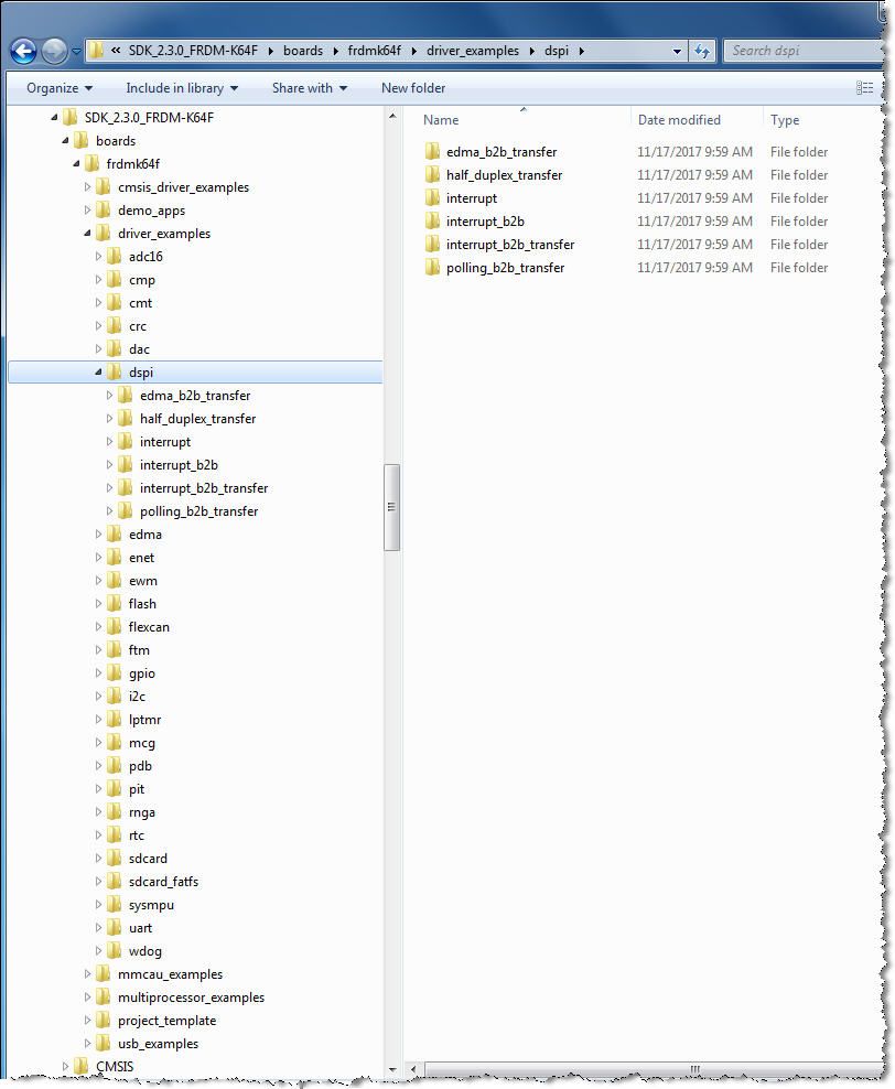

Robin_Shen
Please have a look at MCUXpresso SDK.
It contain a lot of software examples demonstrating the usage of peripheral drivers, RTOS wrapper drivers, middleware and RTOS.
Robin

Hi I fixed the problem here working code :
