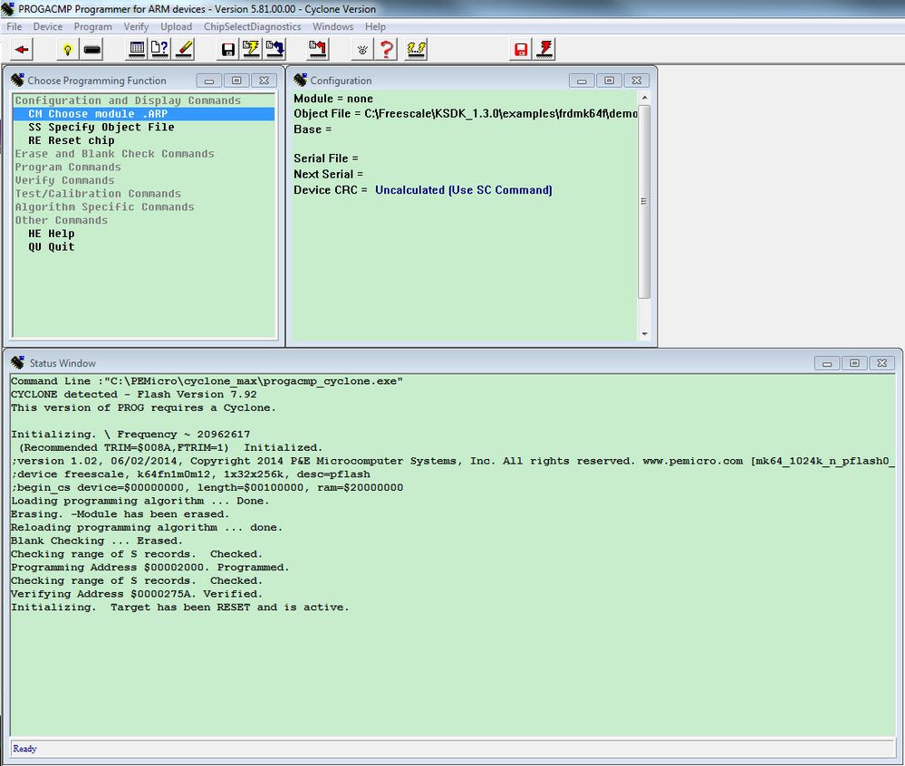

jeremyzhou
Hi Yibin Wang,
I've used the PROGACMP tool to program the FRDM-K64F board according to the step as the Fig 1shows.
However it works well no matter with the kind of image files, such as the BIN, Hex, S19 (Fig 2), and definitely I will move on to dig deeper.

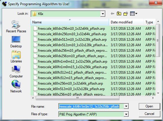

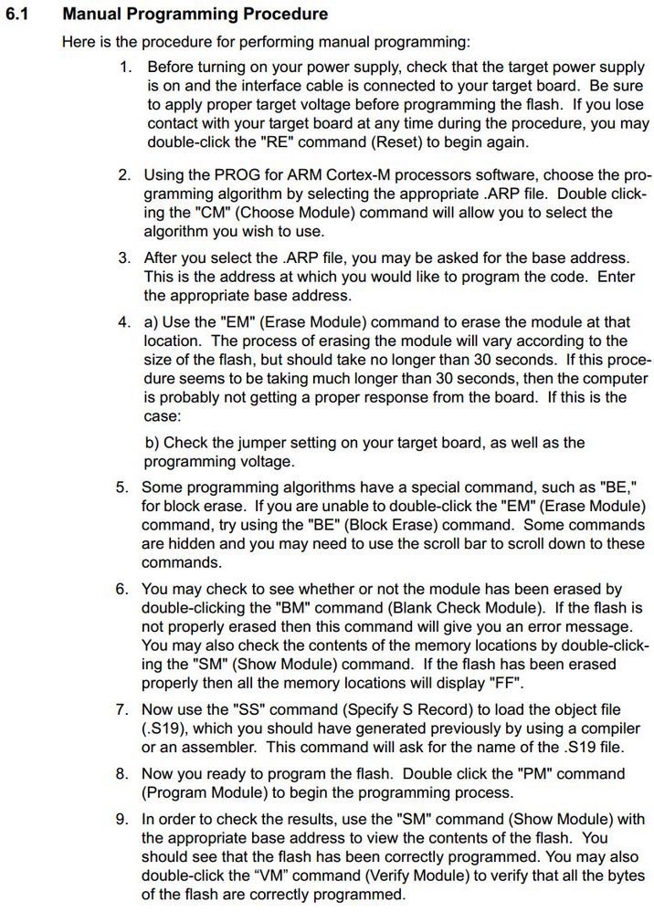

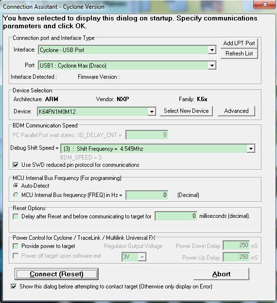

jeremyzhou
Hi Yibin Wang,
First of all, hardware setup: I use the CYCLONE MAX instead of the CYCLONE for ARM devices, from the implementation perspective, they're almost same and I don't have the device on my site now.
Next, connection configuration and load the ARP file.
                                                                          Fig 1
                                                                        Fig 2
Finally, manual programming as the Fig 3 illustrates.
