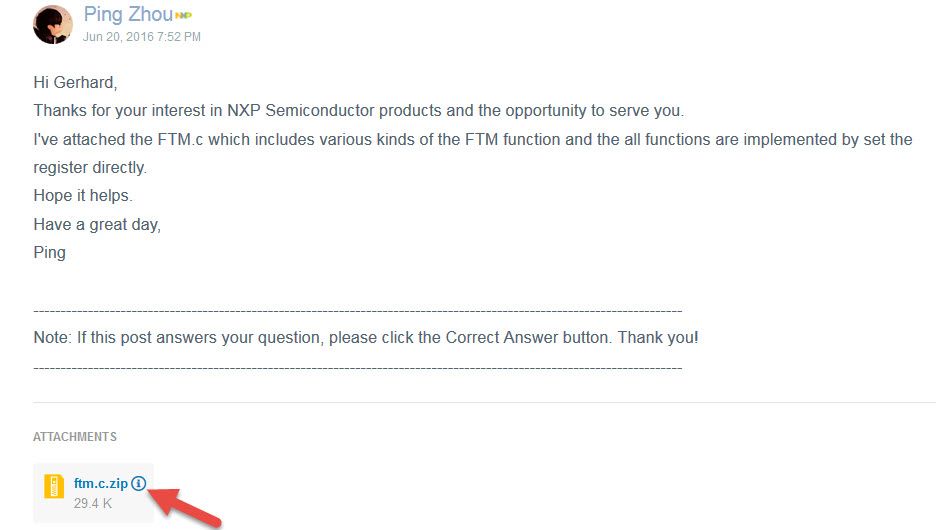

And you can find the ftm.c according to the Fig 1 illustrates.
Ping

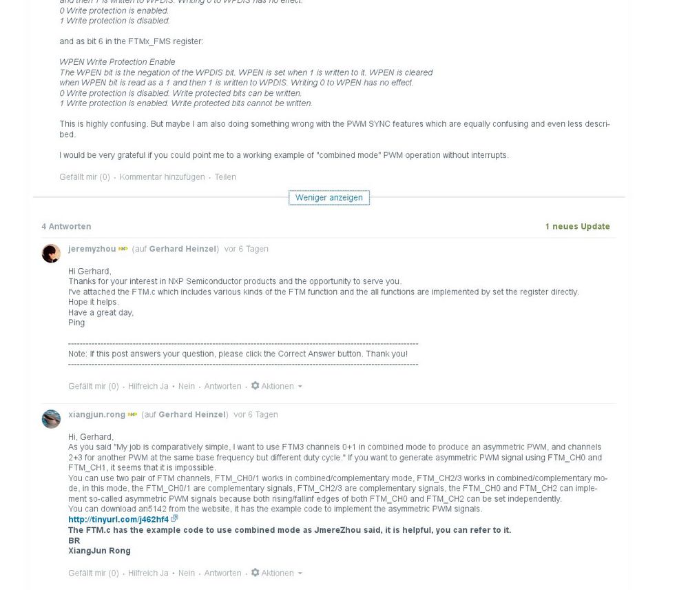

bobpaddock
Senior Contributor III
This forum software has issues.
To see the attachment you must be logged in then click on the heading at the very top of the thread to expand the thread completely, then you see attachments.

xiangjun_rong
Hi, Gerhard,
As you said "My job is comparatively simple, I want to use FTM3 channels 0+1 in combined mode to produce an asymmetric PWM, and channels 2+3 for another PWM at the same base frequency but different duty cycle." If you want to generate asymmetric PWM signal using FTM_CH0 and FTM_CH1, it seems that it is impossible.
You can use two pair of FTM channels, FTM_CH0/1 works in combined/complementary mode, FTM_CH2/3 works in combined/complementary mode, in this mode, the FTM_CH0/1 are complementary signals, FTM_CH2/3 are complementary signals, the FTM_CH0 and FTM_CH2 can implement so-called asymmetric PWM signals because both rising/fallinf edges of both FTM_CH0 and FTM_CH2 can be set independently.
You can download an5142 from the website, it has the example code to implement the asymmetric PWM signals.
http://tinyurl.com/j462hf4
The FTM.c has the example code to use combined mode as JmereZhou said, it is helpful, you can refer to it.
XiangJun Rong

jeremyzhou
Hi Gerhard,
Thanks for your interest in NXP Semiconductor products and the opportunity to serve you.
I've attached the FTM.c which includes various kinds of the FTM function and the all functions are implemented by set the register directly.
Hope it helps.
Ping
