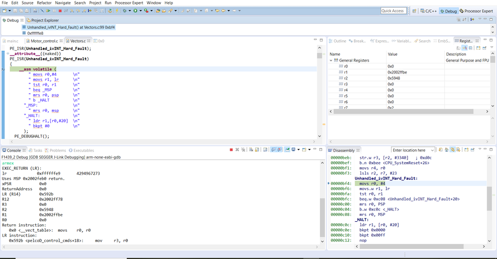

Hi everyone,
Once in a while my program would crash and end up in the below function that belongs to the "Vectors.c" file.  Under what situation would cause a program to crash and trigger it to go to the below function.
PE_ISR(Unhandled_ivINT_Hard_Fault);
   PE_DEBUGHALT();
Debugging ARM Cortex-M Hard Faults with GDB Custom Command | MCU on Eclipse
armex
EXEC_RETURN (LR):
lr                      0xffffffe9             4294967273
Uses MSP 0x2002ff38 return.
xPSR                0x5923
ReturnAddress 0xa
LR (R14)           0x0
R12                   0x20
R3                     0x2002ffbe
R2                     0x0
R1                     0x2002ffbe
R0                     0x2002ff40
Return instruction:
0xa <__vect_table+10>: movs r0, r0
LR instruction:
0x0 <__vect_table>: movs r0, r0

I'm using KDS version 3.2.0. The chip part number is MK64FN1M0VLL12.

  What's the detail code you have added to cause the hardfault problems.
  As I know, if you access the module register which doesn't enable the module clock will cause the hardfault problems.
  You also can refer to the link which you already mentioned to check more details:
