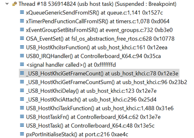

I am working on a K64 project where the processor is directly connected to a USB Hub. I am following the code from the frdmk64f_host_hid_generic_freertos SDK example. I am able to initialize the USB and USB tasks. It gets a "USB_KHCI_EVENT_ATTACH" event and then the IRQ handler for USB gets immediately spammed with USB_KHCI_EVENT_SOF_TOK interrupts and then ends up locking up the OSA_EventSet function because it maxes out at 10 events in the queue then blocks. Any idea why this might be and how I might handle this?

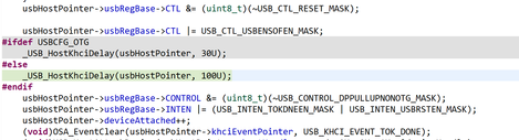

Looking at the code for this I am not sure how this makes much sense to me. It appears that in the attach code there is a 100ms delay

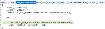

And if you look at how the delay is implemented in the code it counts how many SOF's are received because you get 1 every 1ms so this should count to 100 SOFs to perform the 100ms delay.
But while it is in this loop the events are no longer being processed since the attach function is run from the task that is receiving the SOF events, thus after it counts to 10 SOF's the Event Set throws a failure because the event queue is limited to 10 events. Trying to figure out how the demo works, but my project does not.
