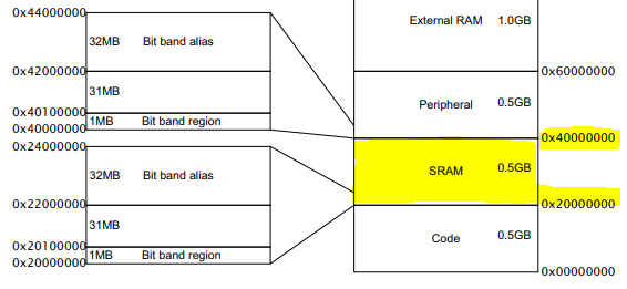

   2-The Cortex M4 ref Manual mentionned that the SRAM section starts from the adress 0x20000000 and can have    0.5GB as size:
   So why we don't use a unique sram block of 256Kb starting from 0x20000000 ?

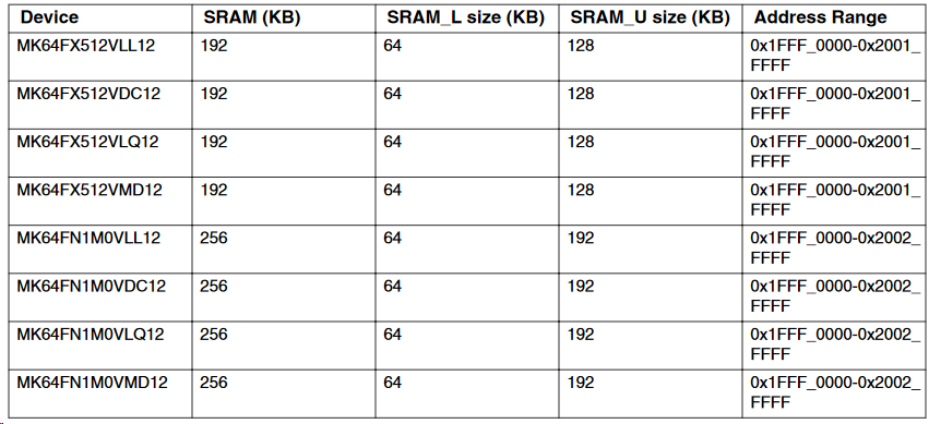

2a. In the following table from the k64 Reference Manual you can check that indeed it can only be used up to 256k. The memory map you used refers to how much memory the M4 could handle, not how much it has:
2b. Due to design reasons, you cannot use a unique SRAM block of 256Kb starting from 0x20000000; the k64 is designed with a Harvard architecture and is set with SRAM_L accesible by the code bus and SRAM_U accessible by the system bus (these buses access the memories through the addresses set for the k64).
3. You can indeed use the totality of the SRAM_U and SRAM_L as long as you remember the precautions you must take that were mentioned by Mark and myself.
