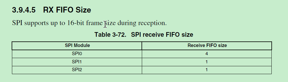

4> Which SPI module you are using? The RX FIFO size is different for different SPI module:
Thank you for the attention.
