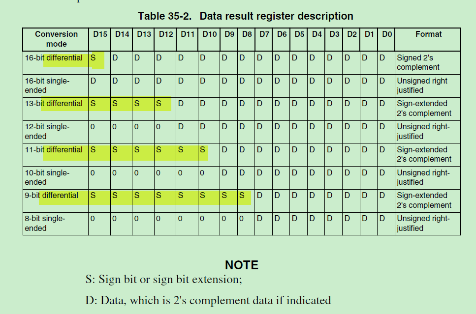

Differential mode works from (1^N-1) /2 , means from minus to plus half range.
there should be a possibility to make it unsigned differential mode
Can some one tell how to do it in the sdk?

Hello Eli Arad ,
   The differential, just have the signed format, please check the K64 reference manual:
Wish it helps you!
If you still have questions about it, please kindly let me know.
