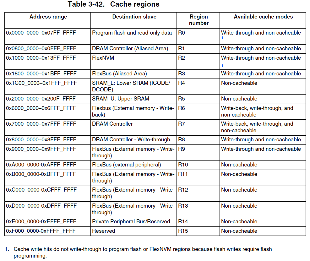

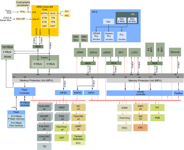

I think the K61 block diagram below will help explain what you are seeing.  The system cache is used on the two master busses from the Cortex-M4 core, called SYSTEM and CODE bus.  Accesses from the other crossbar masters, like the High-Speed USB, do not interact with the cache.  When using RAM that is shared between multiple masters, like the USB buffers and descriptors, that RAM should not be cached.  The internal SRAM is an ideal location for the USB memory, as it is tightly coupled to the core, so doesn’t benefit from cache, and is accessible by other masters.  If you prefer to use external RAM for shared memory, then you can configure a cache region for non-cacheable.  Based on the memory map, you can use different cache policies for different cache regions, and divide your DRAM up between cacheable and non-cacheable regions.  See Cache Regions table below from the reference manual.  For more details on configuring a cache region as non-cacheable, refer to the LMEM_PCCRMR register in the Local Memory Controller chapter of the reference manual.  Best regards
