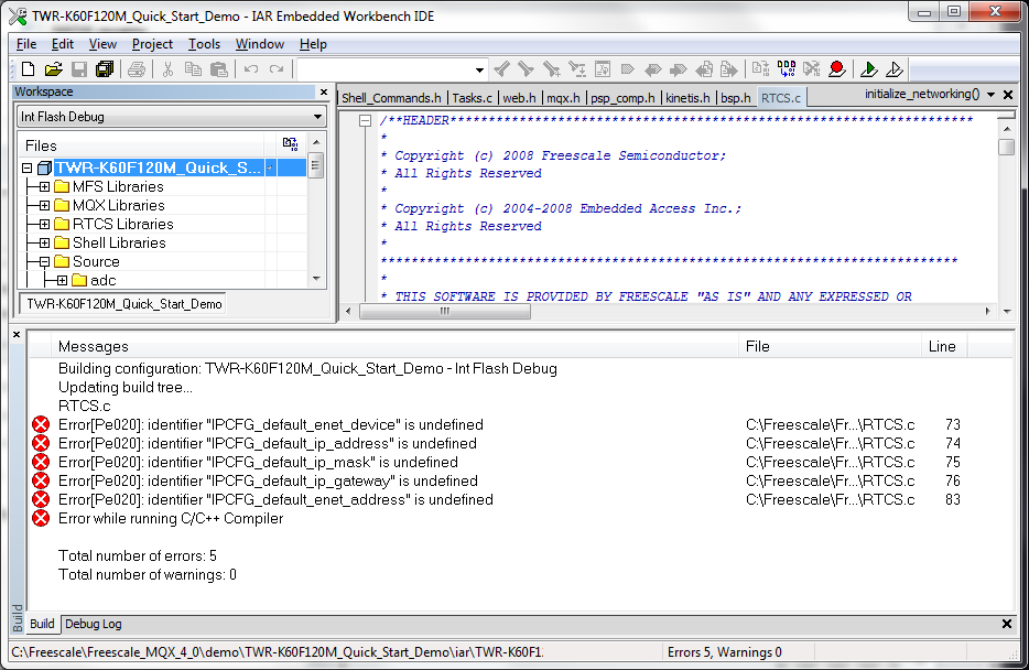

So I'm having issues with building the TWR-K60F120M_QSD demo project for MQX 4.0.1 using IAR workbench v6.6.  Although I was able to successfully build the project using MQX 3.8.1 with my IAR compiler.
It all started with IAR not being able to open certain header files, I figured this out after some googling.  It turns out that the demo project was built with a previous version of IAR and the new IAR versioon (6.6) loses some of the include paths when opening on old IAR workspace project.  After I fixed that problem I then ran into some issues where it was missing some MACRO definitions.  Below is a screenshot of the errors from the IAR development environment.
I added the MACROS shown below into the ipcfg.h file then recompiled the MQX libraries.

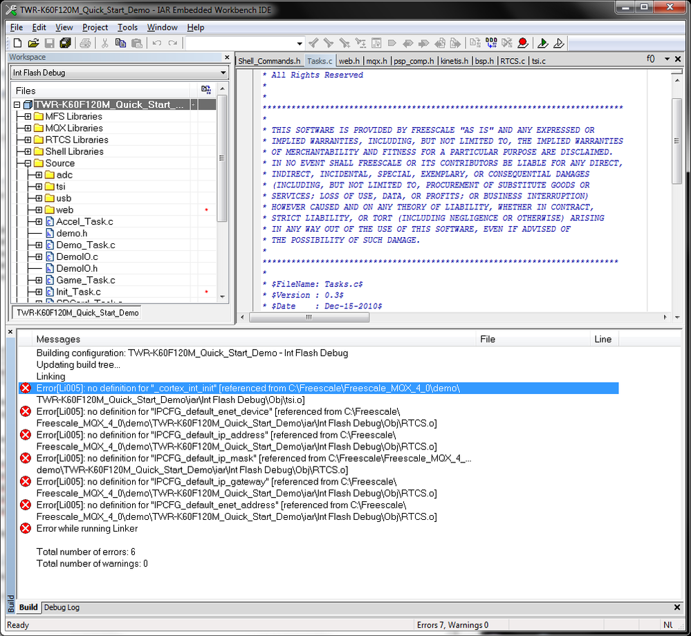

I then switch over to my demo project workspace, in IAR, attempted to build the project.  I then saw the following errors.
   I also see an issue where it can’t find the definition for _cortex_in_init.  If anyone can help that would be awesome.

I figured out why I could not link to the function _cortex_int_init, this was because it is no longer used in MQX versions greater than 3.8.  You simply have to replace _cortex_int_init with _bsp_int_init in the <demo project dir>/tsi/tsi,c file.
For the IPCFG_default macro reference problems I simply had to not used them.  Instead you have to refer to the ENET_  macros in the <demo project dir>/source/web/RTSC.c file.  I also had to properly pass in the third parameter to the ENET_get_mac_address() function in RTCS.c Here is my new RTCS.c file:
