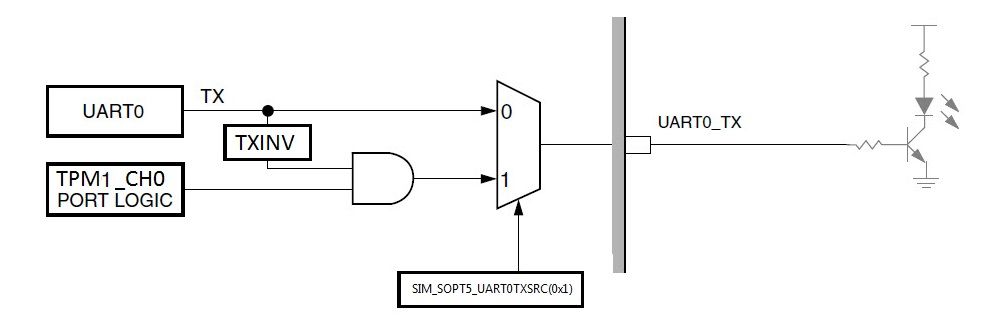

Dear Jorge Alcala
I saw the SIM_SOPT5 have a register is UART0TXSRC and the function descriptions is UART0_TX pin modulated with TPM1 channel 0 output.
It's mean the TX frequency is same to TPM1?

jorge_a_vazquez
Hi Kris
TX modulated means that UART0_TX pin output will pass trough an AND with FTM0 channel 0 before mapped to pinout:
So UART has configured his baud rate as normal, but if the data in 1, the output will have the FTM frequency, this is very used in irda communication, please check: Implementing infrared functions on UART0 with FRDM-KE02Z platform.
