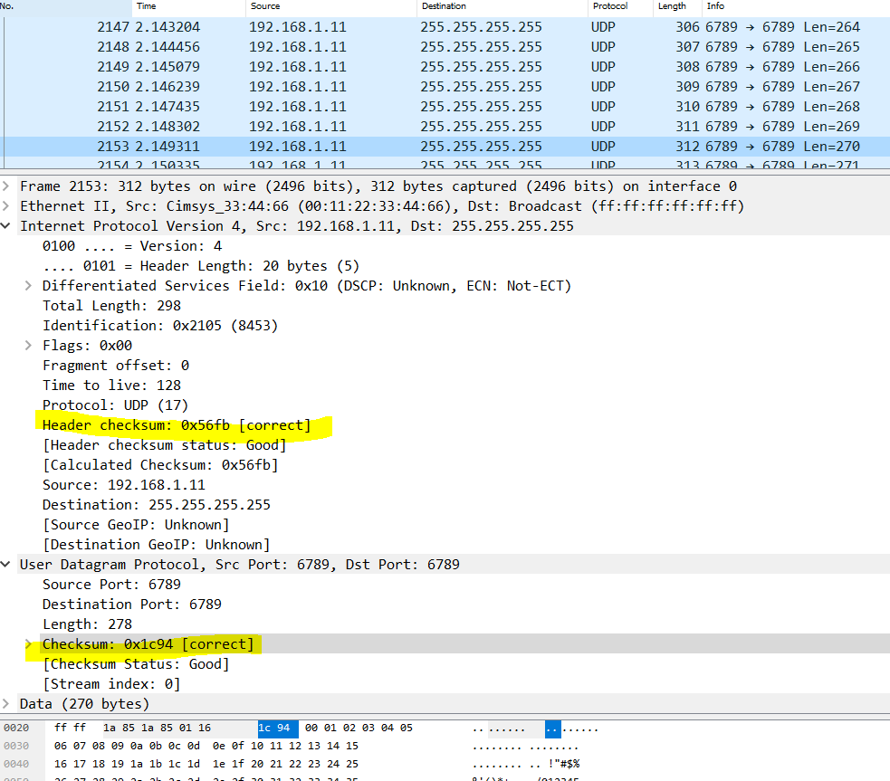

Hi All, K66 hardware acceleration does not work when the interface is set to 100MB. In that case a checksum is only added when total frame length does not exceed 270 Bytes. It's an easy to reproduce and very consistent error. @10MB there are no problems. Maybe the K60 has the same flaw. Not every ethernet device refuses frames with false checksums. So this flaw may go unnoticed up to a point something doesn't work and the whole thing looks unreliable.

Thanks for your email. Enclosed a picture from wireshark where frames with
missing checksums appear black. You see i send frames with increasing
length here. Like i said, this problem may go unnoticed. We did notice
however after we recently had a new router from out internet provider. We
found the DHCP request frame length was a bit longer than the 'critical
size' and checksums were missing. This new router DID TEST THE CHECKSUMS
and DID NOT ACK FRAMES WITH MISSING CHECKSUMS! So there is a real problem
here.
*Make sure the PC running wireshark has RX hardware accelleration turned
off as this also may set a checksum field as shown in wireshark to zero.*

Attached is  FRDM-K66F binary that will send a UDP broadcast, as your application is doing, each 1ms.
It increase the payload form 1 byte to 1023 bytes and then back to 1, etc.
It uses UDP checksum and IP checksum offloading, plus IP payload checksum offloading.
I don't detect any issues - the frame with 270 byte payload looks like
You can load the attached binary to a FRDM-K66F to check at your end.
Are you using both IP and payload offloading? Which of the check sums is failing? Be sure that you always set the checksum values in the frame to be sent to 0 - leaving a random value or non-zero will cause it to generate/insert a bad value.

Hi Mark,
Thank you for your great help. Of course i initially falsely interpreted
your good answer. I am pretty convinced now there is something in my code
that makes the offloading fail. Maybe it was unfortunate i initially tested
with a router that did not look at the checksum, and did not see the
problem earlier. Anyway i have to find out what that is so i will do more
experiments.
I use both IP checksum and UDP/ICMP offloading. I do set the initial values
to 0x0000. If the IP checksum fails, UDP checksum also fails. They both
fail or both are both OK. I will test ICMP also by putting more data in the
ping. I run RMII on a K66, so the FRDM board seems a good reference. CPU
speed 180 MHz. Running at 10MB/s everything works fine. Only running
100MB/s i see the problem.

s_busman
Mark,
Enabling the TFWR bit solved the issue. Appreciate your help.
