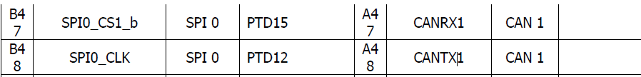

I have an external transceiver working with CAN0 (Rx/Tx pins on PTC16/PTC17, which are also on B41/B42). Instead of using the peripheral board's transceiver, I used my external transceiver. This is to confirm that the external transceiver is working.
But I still have issues with CAN1 (Note: CAN0/CAN1 a little confusing: using PE, PTC16/PTC17 is on CAN0 ).
I tried to use PTB19/PTB18 as Rx/TX, on B66 and B72, which are used as EBI_AD15, EBI_OE_b. I am not sure that can be done?
I also tried to use PTA12/PTA13 (A25/A23) shared with ethernet. But it doesn't work.
I don't know the A47, A48 as CANRX1, CANTX1, what that means? I thought they have to be selected through PE using PTA12/PTA13, etc.
(From TWRK60F120MUM.pdf)

David
A4 7 refers to the back plane connections and not the chip and you need to check whether these are actually connected on the K60 tower card.
There are two possible connections (muxing at the chip) as follows:
        #if defined CAN1_ON_PE
        _CONFIG_PERIPHERAL(E, 24, PE_24_CAN1_TX);                        // CAN1_TX on PE24 (alt. function 2)
        _CONFIG_PERIPHERAL(E, 25, PE_25_CAN1_RX);                        // CAN1_RX on PE25 (alt. function 2)
        #else
        _CONFIG_PERIPHERAL(C, 17, PC_17_CAN1_TX);                        // CAN1_TX on PC17 (alt. function 2)
        _CONFIG_PERIPHERAL(C ,16, PC_16_CAN1_RX);                        // CAN1_RX on PC16 (alt. function 2)
        #endif
See also the following video for simulating dual-CAN and the K60: https://youtu.be/Ha8cv_XEvco
Mark

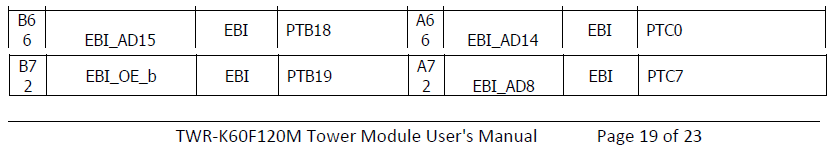

davidzhou
Contributor V
Hi Mark,
Thank you for your reply.
I was using PTB19/PTB18 as CAN0 Rx/Tx. The code is created using PE. The pins are on expansion B (B72/B66) I believe. I don't see any tx or rx signals on the pins when I scoped. I am not sure those pin are directly tied to the micro chip, because they are used as touch pads:
I don't know is there any way to disable the touch pad function, or jumper to some pins so they are directly tied to the micro. I have hard time time to find the schematic of TWR-K60F120M primary and peripheral boards.
David
5,247 Views
mjbcswitzerland
Specialist V
David
On the TWR-K60D100M the signals are indeed connected as shown (PTB18 to B66, for example).
If you enable the CAN0 pins for CAN function the TSI function is switched out.
Mark
