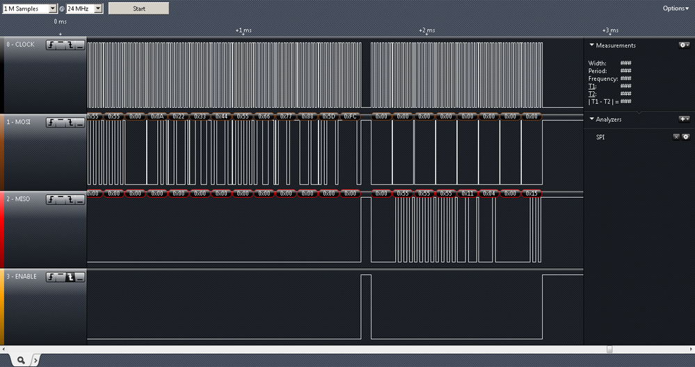

I am using K60 as SPI Slave mode. my code push the data frame (0x55,0x55,0x55,0x11,...)to the TXFIFO and wait the SPI Master to read out. But the master will read out the data frame as (0x0,0x55,0x55,0x55,0x11,....). I do not know why there is an extra '0x0' received. I grab the bus wave and found the 0x0 is sent on the MISO .Please refer to the attached pic. I did debug by step-by-step check the FIFO filling action,and no issue occured, no '0x0' was insert into the fifo.
Why the SPI controller will add an 0x0?
Btw, I found in the K60 RM(50.4.6 Slave Mode Operation Constraints), it said "The transmit data is transferred at second SCK clock edge of the each frame to the shift
register if the SS signal is asserted and any time when transmit data is ready and SS signal is negated."
What is this mean? Does the issue related with this?

Well, it turns out that the slave can not response the SPI master ASAP. Seems the slave is too slow.
Even the data has already been pushed into the FIFO, the slave can not put the data to the shift register ASAP, and the underflow issue occured.
I have to add delay between each two bytes transfer at master side.  The acceptable minimal delay is about 32uS if the master inactive the SS between each transfer.
And if SS is not inactive between transfer, the acceptable minimal delay will be much longer.

Is it possible that the Master device is requesting data before the Slave has pushed data to the FIFO (and transmitting an empty register value 0x00)? Also, what are your SPIx_CTAR_SLAVE[FMSZ], SPIx_CTAR_SLAVE[CPHA] & SPIx_CTAR_SLAVE[CPOL] settings for the Slave device?

No, it is not the case. Because only after the slave push all the data into fifo, it trigger a GPIO as interrupt to the Master, then Master will start the spi transfer.
Part of my init code is as follow:
