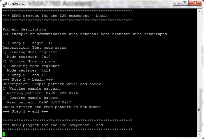

Does anybody know how to output the K60 tower board's accelerometer measurements via I2C Protocol and ProcessorExpert? I tried the example in codewarrior, debugged it, but it only returns descriptions, not measurements:

Hi Dao,
I am not sure if you are using TWR-K60D100M tower board do related test? If yes, you need to select to use TWR-K60N512 board, which is using K60 100MHz silicon 1.x product.
If you want to use related code with TWR-K60D100M board,  you need to do some porting work, select the CPU component (MK60DN512VMD10 without 'Z' character).
I could run related code with TWR-K60N512 board without any problem.
Please check below attached serial terminal print info:
Thank you for the attention.

Thanks a lot for pointing that out, I must have changed some configurations to get an error message. I reload a fresh example and the description showed no error.
I guess I didn't phrase my question clearly. I was wondering how I can program the board to print out the accelerometer's measurements in real time for example X = 2.0, Y = 0.0, Z = -1.0, instead of the above descriptions.
