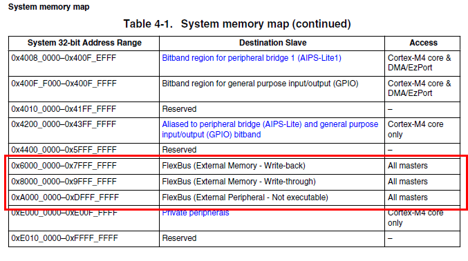

juanandujar
Hello Kan_Li,
I know that the flexbus is able to work in the way you mention. However, my question is if it is possible to employ the upper bus for the address( FB_AD[16:31]). For instance, the data bus can be placed either in the lower or upper of the bus. With the address bus is possible to work in the same way.
5,975 Views
Kan_Li
Hi Juan,
Actually I dont think it is possible to put address info on FB_AD[16:31] as this would exceed the address range mapping for flexbus , for example, if you want to access the data in 0xFFFF, you have to set the address pointer pointing to 0xFFFF0000 to drive 0xFFFF on FB_AD[16:31], but from RM, 0xA000_0000–0xDFFF_FFFF is the max mapping address range for flexbus. so that data info would not be driven on FB_AD[16:31] either.

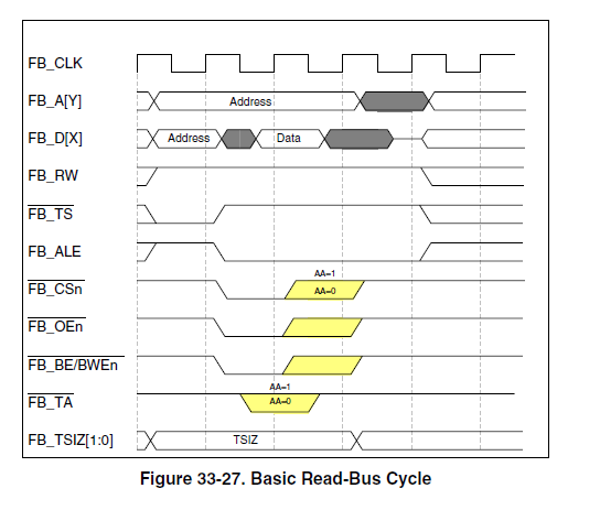

Kan_Li
FlexBus timing is based on the FB_CLK signal, and it is 50MHz at max, while SRAM is based on the system clock, which is 100MHz or 120MHz depending on the part number, but if you select 120/150MHz part, which can enable cache for flexbus, so that would help to increase the performance. and there are 32 address lines available for this interface, but to enable the cache feature, the maximum size of SRAM can be 512MB. please kindly refer to the following for details.
Hope that helps,
B.R
Kan

sithara
SRAM is asynchronous. Then what is the significance of FB_CLK?

Kan_Li
Yes, I know external SRAM might be asynchronous, but the timing for signals of flexBus is based on FB_CLK, for example, the following figure shows the basic reading process of the flexBus.
so FB_CLK's frequency impacts the flexBus performance.
Please kindly let me know if you have any issue.
B.R
