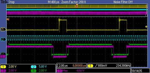

blue - SCLK, violet - FSYNC (up for 24 periods), green - saturated data (0x7FFFFF), yellow - doesn't matter.
I used SCLK rising edge to trigger the DMA (one byte minor loop, 24 bytes major loop) and FSYNC signal was meant to enable the DMA (which would get disabled after every major loop). Another thing is that I need to do the data postprocessing immediately after I gather the samples and it takes a little bit longer than the time to next FSYNC rise (next data packet). If I used one DMA it would start overwriting the data being currently processed and that's bad. That's why I wanted to use two DMA channels with exactly the same configuration and only one difference: the destination buffer address. They were supposed to run one after another in cycles so I have time to proccess the data.

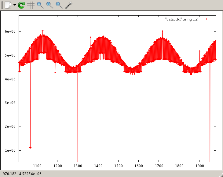

Now here's the issue: Always the channel with higher order number reads corrupted results. If I used (as in example above) channels 14 and 15, data from channel 15 was wrong. If I used 12 and 14, the 14 became corrupted. Nothing changed as I modified the priorities and preemption settings so I assume it has something to do with the DMA channel order.
Here's an example image (every second sample is incorrect but in some regular way):

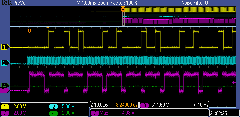

From the image below it looks like the second DMA always kicks off too early. The weird thing is that the data (inspected in the debugger) do look OK actually. I enabled DMA13 HALF and MAJOR interrupts to check if maybe the third DMA was causing the issue but they both were in correct places (right after the FSYNC rising edge).
blue - SCLK, violet - FSYNC (up for 24 periods), yellow - data postprocessing in DMA ISR.
