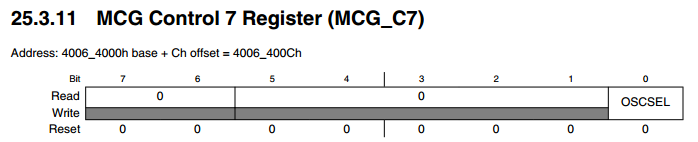

ericfoote1
Nick,
Might this be the register you're looking for?
5,782 Views
norton256
Yes it is. I had found that yesterday, and am currently in the process of implementing it.

norton256
After your last post that is what I was beginning to suspect. Since my external clock source is not present at the time when I need to be using CAN, I need to switch the system to use the RTC which has a 20ppm tolerance. So far I haven't come across the MCG register which switches in the RTC to the FLL.
