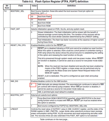

As you know that the K32L2 has flash configuration area, after the chip starts up, the core will copy the data in flash configuration area to the FTFA_FOPT register automatically.
The PTA4 is multiplexed with PTA4, pls connect PTA4 to a pull-up resistor.
Secondly, pls clear NMI_DIS bit in the FTFA_FOPT register. In the case, NMI_b pin will not fire interrupt.
Hope it can help you
XiangJun Rong

"Adding 10K pullup to both these lines - problem remains"
SWD_DIO has internal Pull-Up. SWD_CLK has internal Pull-Down.
Pulling both up at reset probably looks like a debugger clock pulse as a guess. Fingers and such would pull down long enough.
The internal resisters are rather high-Z and vary with temperature (20k to 50k).
I usually add my own of lower-Z.
From the electrical data sheet for the K32L2A:
"While pull-up or pull-down resistors are not required
(SWD_DIO has an internal pull-up and SWD_CLK has an internal pull-down), external 10 kΩ pull resistors are recommended for system robustness. The
RESET_b pin recommendations mentioned above must also be considered."
