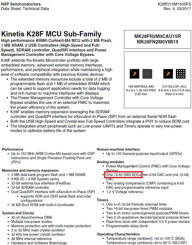

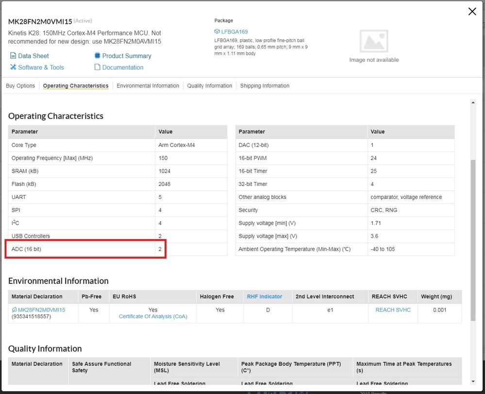

Hi All,
While study K28, how many ADC dose it have?
The number of ADC is difference from website and datasheet.
This is snapshot from the website.
This is snapshot from the datasheet.

Robin_Shen
Hi Leslie,
Sorry for the inconvenience!
K28 has only one 16-bit SAR ADC(ADC0).
I did not find the pins or registers of ADC1.
Robin

leslieyang0509
Hi Robin,
Thanks for your reply.
We just need to confirm the specification of K28.
K27/K28 both has only one 16-bit SAR ADC, is that correct?
Leslie
2,944 Views
Robin_Shen
yes
You are correct.
