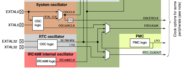

I am using a 32 khz crystal connected to extal32 and xtal32 and running the output to the rtc_clkout pin.
What is the lowest power mode that this function will work ?
The reason I ask is the reference manual says rtc_clkout is disabled in LLS and VLLS2 modes suggesting
VLPS is the lowest power mode at a typical of 57 uA.
The problem we see is that this function is still working in VLLS2 mode. Is the manual wrong ?
If not, why is it still working ?

I tested this case scenario in my side and I couldn't replicate your problem. Could you tell me how you test this?
I used the demo code included with SDK drivers, located in the path: {SDK_2.0_TWR-K24F120M}\boards\twrk24f120m\demo_apps\power_manager
This code already set up different power modes. Then I just add the following code to see RTC_CLKOUT:
PORT_SetPinMux(PORTE, 26u, kPORT_MuxAlt6);
/* RTC set up */
rtc_config_t rtcConfig;
RTC_GetDefaultConfig(&rtcConfig);
RTC_Init(RTC, &rtcConfig);
RTC->CR |= RTC_CR_OSCE_MASK; /* Enable the RTC 32KHz oscillator */
RTC_StopTimer(RTC);
CLOCK_SetRtcClkOutClock(0); //Select 1HZ in RTC_CLKOUT
RTC_StartTimer(RTC);‍‍‍‍‍‍‍‍‍‍‍‍‍‍‍‍‍‍‍‍
I run the code and I saw the signal in my scope, and if I set the MCU to go to LLS or VLLS mode, this signal disappear. Could you try this set up and tell me how it goes?

Hello Jorge,
To be clear I am asking about the RTC_CLKOUT. The output
we were able to go down to VLLS2 and still see the 32kHz come out.
From manual:
As you noted above the manual says the rtc_clkout is not available. If this is true why do we see it ?
Are there any configurations that would allow this to happen in a VLLSx mode ?

Could you clarify what you mean when you see is that this function is still working in VLLS2?
Reference Manual has a note that says:
So, the RTC is Full Functional, but it has a note that mentioned:
8. RTC_CLKOUT is not available.
So the RTC module is still functional but you have not available the RTC_CLKOUT output;
