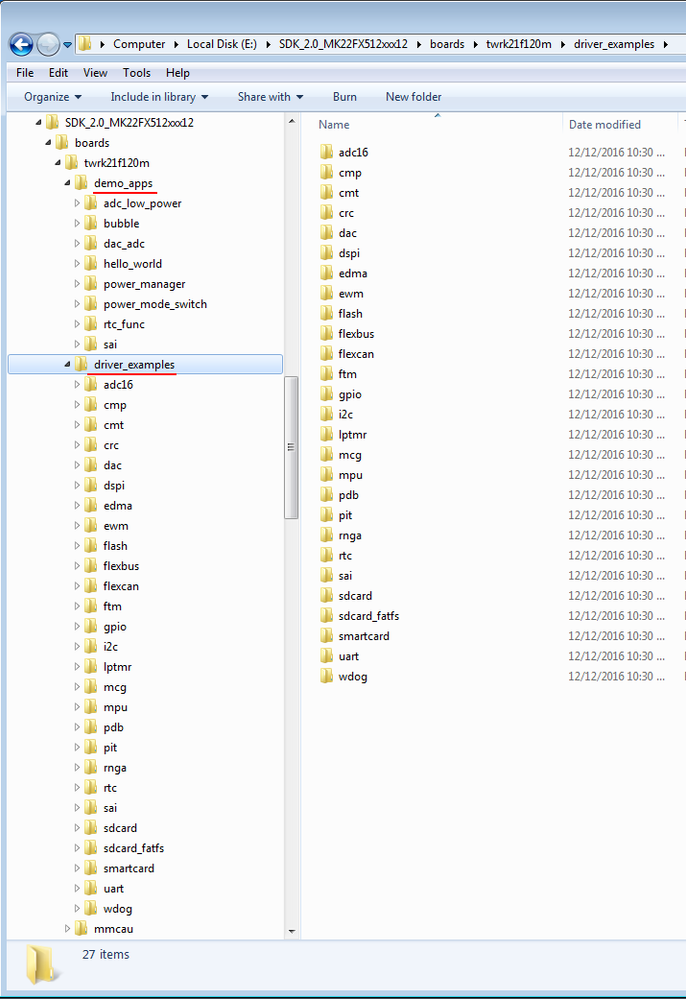

Hi Everyone.
We are using MK22Fx512 controller. We are using Code warrior as IDE.
I need example code for below to kick start new project.
1) LED Blink
2) all interrupt enable/disable
3) Timer program
4) setting Timer interrupt
Thanks in advance.
1,645 Views
Robin_Shen

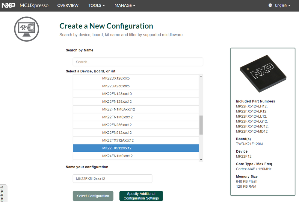

We recommend you using Kinetis Design Studio IDE.  CodeWarrior IDE Support to Change for Kinetis® Devices. Read More
There are many examples in SDK_2.0_MK22FX512xxx12. You can select and download it.
You can getting start with KSDK and KDS from reading below:
 "How to start with KSDK"  and "KDS Document List".
Robin
