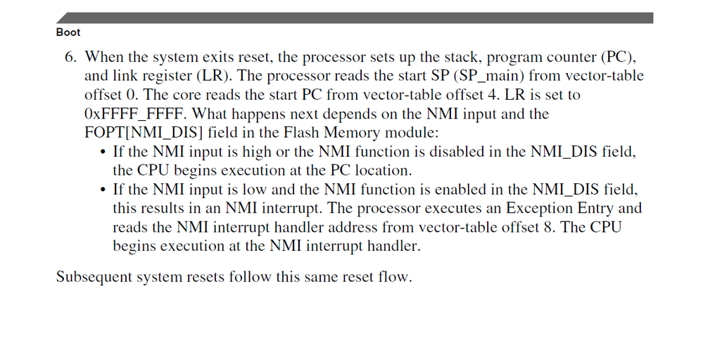

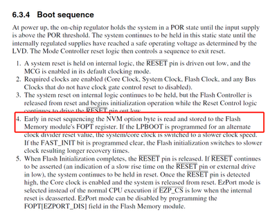

nxf58904
As the follow picture shows,the Flash configure area (FOPT) was loaded on reset.
You have a loader application, X and Y applications in flash,but you should only set  FOPT at 0x0+0x400(loader application).
