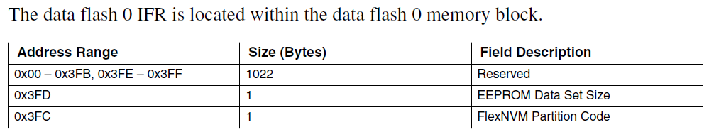

From the reference manual for the MK22FX device, the Data Flash 0 IFR section should have the EEPROM and DEPART codes at the following locations:
For the Data Flash 0 IFR, our resource select code is 0x00 and the local address range is 0x80_0000–0x80_03FF.
Data in FTFE is big-endian, and the flash address must be 64-bit aligned, which means I need to read at 0x8003F8 to get the start of my block that will index into the IFR.

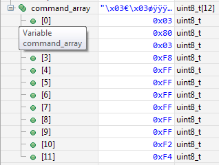

Using a DSTREAM ICE, the corresponding FCCOB registers that are returned from a previously partitioned device are:
The indices in command_array (above) correspond directly to the FCCOB number, so FCCOB[0] = 0x03, which is the Read Resource command.  The address is 0x8003F8, and so forth.  I am reading in the full 12-bytes from FCCOB.

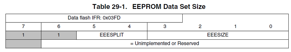

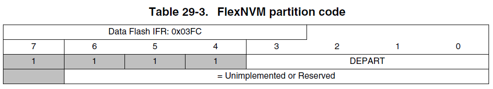

Since I expect my data to be at 0x03FC, 0x03FD, and my 8-byte buffer (now in FCCOB) starts at 0x03F8, I should expect my data to be in FCCOB[6] and FCCOB[7] (right?).  Yet, looking at FCCOB[6] and FCCOB[7], above, we see that these are 0xFF bytes.  It almost appears that the actual EEPROM data size (and split) and DEPART codes are stored at FCCOB[A] and FCCOB[B].
Note: reading the SIM_FCFG1 register gives me valid results for EESIZE and DEPART, and I can start to use that to determine if the partition is created, but all of our other code relies on the Read Resource command and I'd like to understand this better anyway...
(For completeness, I've included the EESIZE and DEPART codes so it can be seen that command_array[10], command_array[11] might actually contain valid partition codes.)
My goal is for EESPLIT to be 0x3 (1/2A + 1/2B), EESIZE to be 4096 Bytes (EEPROM code = 0x32), and for the partition code to be 64 kB Data Flash and 64 kB EEPROM Backup (16x 4 kB) (DEPART = 0x4).

I would expect the values you are looking for to be returned in command_array[8] and command_array[9], but I do agree that what is coming back in command_array[10] and command_array[11] appear to be the values you are trying to find. Are you sure the array is directly mapped to all the FCCOB registers? Unfortunately the standard tower board we use for that part uses a part that doesn't support FlexNVM, so I don't have a hardware setup at my desk that I can use to double check this. Overall, using the SIM_FCFG1 is a much easier approach, and you won't have to worry about endianness of the data.

Thank you, Melissa, for helping to confirm some of what I suspected.  I'm so used to thinking in little-endian that I may have forgotten some of the nuances of multiple-byte conversion from LE to BE.  Looks like the C90TFS driver swaps entire long words and then swaps the bytes as well, but even taking various permutations of endianness conversions, I can't reconcile why the EESIZE, EESPLIT, and DEPART codes are showing up where they are.
For now, I have switched my partition checks for all of the K10, K22, etc. devices to use SIM_FCFG1 to check the partition code.  It looks like the FTFL and FTFE write partition commands work as expected, so that's good (i.e., the values programmed end up getting reported back in SIM_FCFG1, just not in the Read Resource data).

You are right, the EEPROM Data Set Size located at 0x3FD and FlexNVM Partition Code located at 0x3FC, which should be at FCCOB[6] and FCCOB[7].
