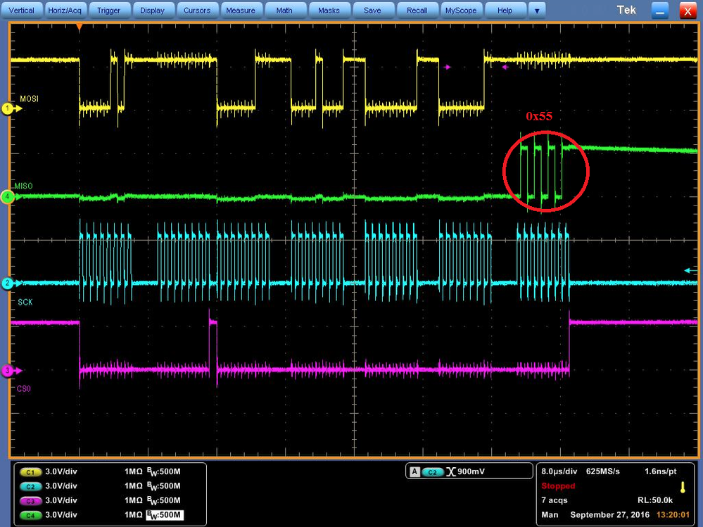

Hi everybody,
Im working with a K22 and a M25P16 flash memory.
Im using the following function to communicate by SPI:
"void fnSPI_command(uint8_t ucCommand, uint32_t ulPageNumberOffset, volatile uint8_t *ucData, uint32_t DataLength)"
So far, i can read the manufacturer register and also the status register succsessfully.

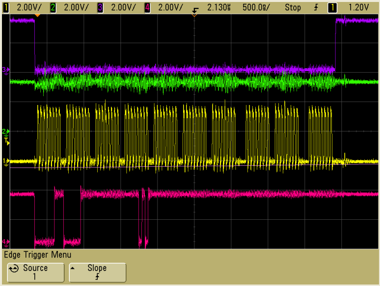

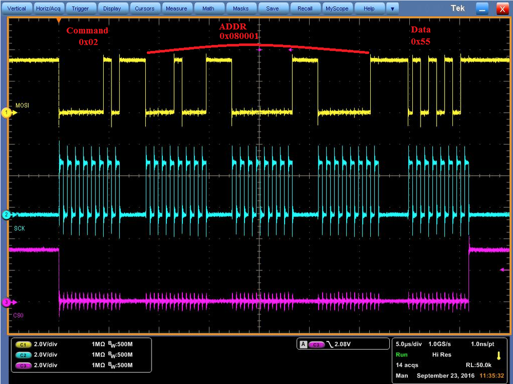

When i try to write data, i see how the SPI signals MOSI, SCK ad CS are OK
But when i try to red the data:
   1- If i try to read 1 byte, i can't see anything at MISO and the code gets stuck at the first red code line.
   2- If i try to read at least 2 bytes, i can see 2 bytes at MISO but the code gets sutck at the second red code line

By the way, if i chage the value of ucTxCount = 1;//4; i receive data on MISO, i can't read it back from the function though. I get u8prueba = 0
fnSPI_command(READ_DATA_BYTES, 0x80001, &u8prueba, sizeof(u8prueba));
Any help will bw apreciated.
