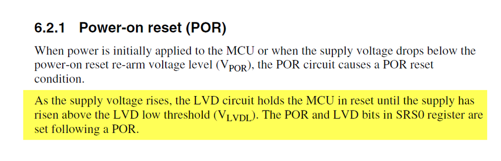

Hi Christopher,
   The POR is automatically controlled by the MCU, the LVD can provide the falling voltage threshold and trigger a interrupt.
   About the POR information, please associate the reference manual and the datasheet:
So, if you just want to use the POR to detect the VDD,this is controlled by the MCU automatically, you don't need to use the PE component, even you want to use the LVD to detect the falling voltage threshold, you can use the PMC module register to control it directly.
Wish it helps you!
