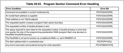

According to the user manual there are various things that cold have went wrong
As per your description , we may eliminate current mode security  or invalid  flash address error conditions.

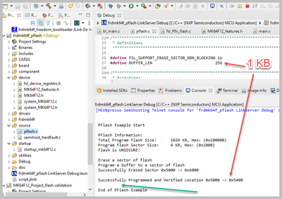

Could you try to write only up to 1KB with program section command?
According to below snaps from the MK21  RM, the FlexRAM  section program buffer will hold up to 1 KB of data for the program section command. I think that you mentioned that you are trying to write 0x1000 bytes , or 4KB.
I am mentioning this , as I  have been running the MCUXpresso SDK pflash demo  with specific modifications to pflash.c on my K64F: (as I do not have any MK2x board with me during this Corona virus lock down)
1 Use your address of 0x5000
2 Use the FLASH  function for  program section command, not program  FLASH_Program. If we leave that last one, we can program 4KB. If I am not wrong , that function  programs each 8 bytes, using like your current workarround, the  program phase command.
3 Play with the length of the dummy buffer that the demo uses for writing in to the flash. As it is expressed in 4 byte words, that 256 corresponds to 1KB.
Below , find my relevant test results:
A) Using  1 KB  for buffer length,  no errors, see console results:
B) Using more than 1 KB, or 4 KB , we have flash errors
In particular the below  error corresponds to when I used a buffer with a length of 4 Kb.
The FTFx_FSTAT_ACCERR_MASK error is raised.
Therefore , my recommendation is to test program section command for 1 KB and check our MCUxpresso SDK pflash examples and use latest MK21 flash driver. This can be found at MCUxpresso SDK builder. I have mentioned the TWR-K21 Plash example as uses a similar MK21.
