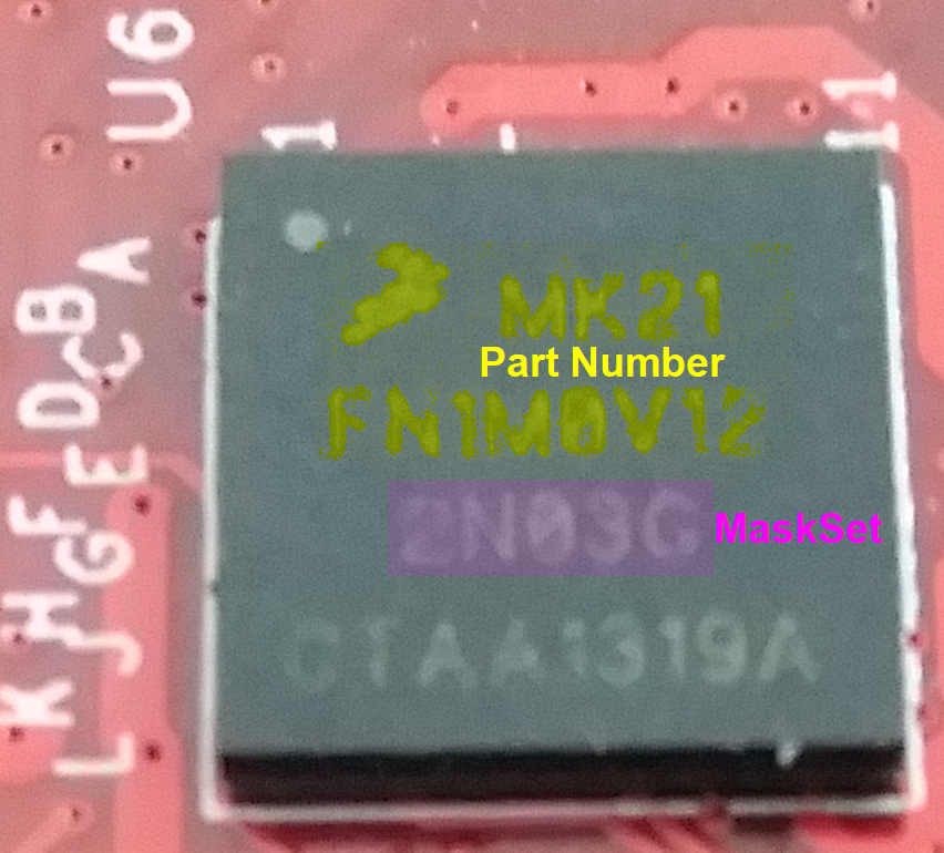

Would you please tell us the MaskSet and PartNumber of the two versions K21 chip?

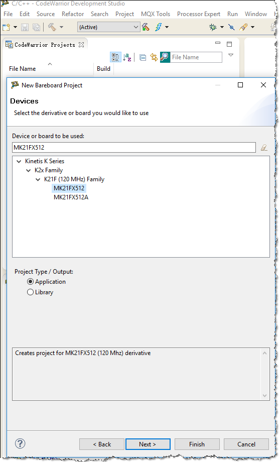

When create an MCU project based on Processor Expert, I can only find the difference between Device(MK21FX512 and MK21FX512A).
It will include difference headfiles(base on different Reference Manual K22P121M120SF5RM and K22P121M120SF5V2RM).

HI Robin, Thanks for the suggestions. I didn't know that number was the mask set.  Information as follows:
The old 'Rev1' chip (as reported by BDM) is MK21FX512V12/2N03G.  It has VBAT fed by battery and +3.3V via a diode.
The later 'Rev9' chip is MK22FX512VLK12/1N41K.  VBAT is floating on this system.  I'm convinced that this is the reason for the exception.

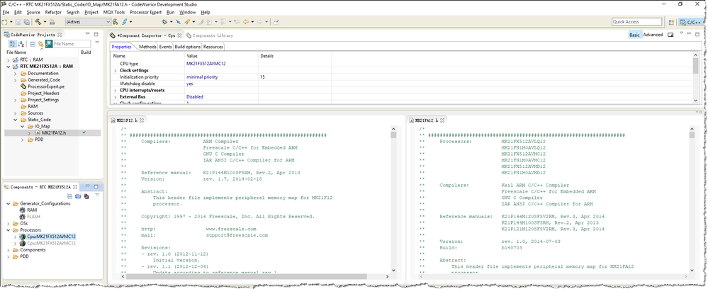

The PartNumber should be MK22FX512AVLK12 for the MaskSet 1N41K, please download the corresponding K22P80M120SF5V2RM and K22P80M120SF5V2.
The difference of register will cause hardfault.
Please try to reconfigure the MCU PartNumber in Processor Expert.

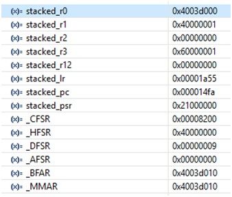

Using help from Erich Styger I've ascertained that the interrupt is a Hard Fault. Not sure if that helps diagnose the fault.
My register dump is as follows:
Not really sure what to do with that info, tbh.
