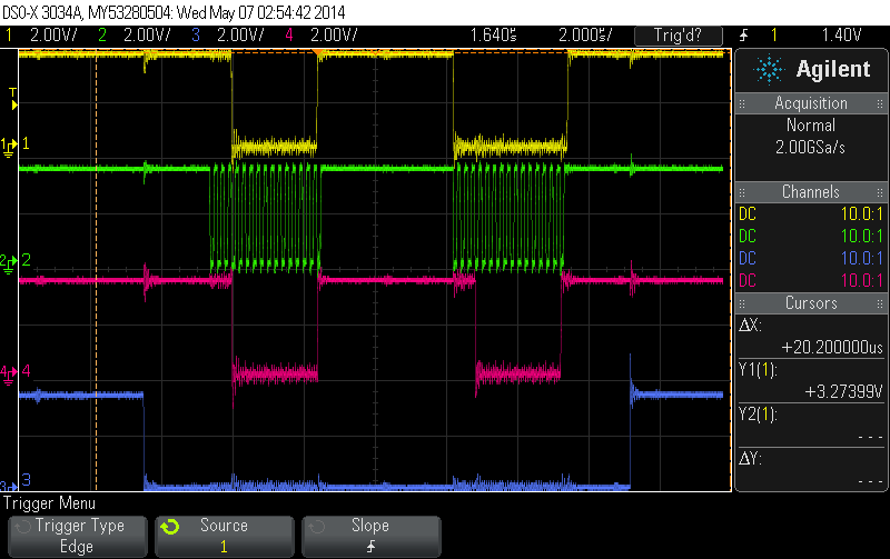

I am having problems using the K20DX256VMD10 is SPI slave mode, I get an extra zero bit shifted into the RXFIFO resulting in my 32-bit receive frame being shifted one bit to the right. I send (0xE001 0000) but the K20 reads (0x7000 8000). I am using the exact same SPI software I have running on three other projects using a K20DX256ZVMD10 processor, and they all work fine. I have tried this same exact SPI driver software with K40, K60 & K70 tower boards and they all work fine. The only thing I did different is use SPI2 on port-D, where the other projects I use SPI2 on port-B.
Here is what my 32-bit frame looks like:Yellow is SPI-In, green is clock, red=Out, blue=CSscope_881.bmp
Here is a close-up of the 1st 16-bits:scope_882.bmp
I am changing on leading edge and capturing on trailing edge. My SPI2_POPR is all zeros at the start, but the K20 sees 0x7000 in the 1st 16-bits, it should see 0xE001, like the scope shows. The 2nd 16-bits reads 0x8000, and the scope clearly shows all zeros.
This is crazy! everything looks good. I plug any of my other three K20DX256ZVMD10 project boards onto this SPI master and they all read (0xE001 0000) just like they should.

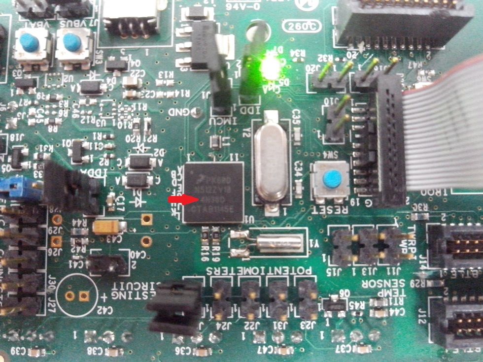

Hi Tom,
Can you share with us the silicon mask of your functioning and non-functioning devices. The silicon mask is printed below the part number on the microcontroller (See image)
Saludos
Santiago Lopez
881 Views
cavebiker
Contributor V
Hey Santiago Lopez,
4N22D is the mask, But the problem seems to be in my court. I just now realized I did a board a while back that uses this same part and the same SPI port and pins, and that board works. And my new code runs the same on that board (bad) but it runs good on another board with the other K20. Weird, but at least I know I can make it work.
