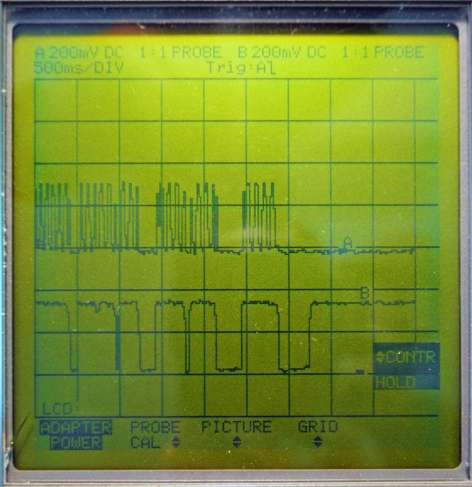

Hello everyone,
I am using for the first time a K20DX 128VLH5, the Init hardware sequence should be:
- watchdog unlocking
- external oscillator with PLL at 50Mhz enabling
- low voltage detect high mode enabling
Everything seems fine but when there are repetitive short interruptions on main voltage, the built in oscillator hangs and my board stop indefinitely. Is out there someone else with my same problem?
Attached you’ll find hang sequence as seen on my oscilloscope. (A curve is external oscillator, B curve is processor reset pin)
Kind regards
Alvaro

Hello Santiago,
during the short interruptions on main voltage the MCU
restart correctly, but after 5-10 click the system will be stopped for ever. To
restart it I shut down the supply or give a manual reset on the pin.
It’s impossible to give short interruptions on main
voltage in debug mode.

Hi Alvaro,
It seems like the MCU is soft-restarting for some reason, maybe something with the code. Did you try debugging your code to see in which specific part of it the MCU is restarting or hanging? It would be great if you could share your source code with us.

This sounds similar to a problem I had.  I had probably fried my board playing with 12V power.  It would run just fine in reset default slow clock, but when it tried to start using the external oscillator and PLL at 50 MHz it just died instead.  I chunked it, got a new one, and hope to be more careful the next time I start wiring the 12V peripherals.
Roger
