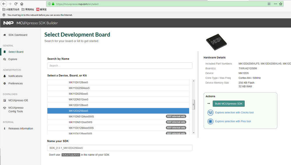

  1. Download the SDK_2.3.1_MK12DX256xxx5.zip from this link:
Welcome | MCUXpresso SDK Builder
   Choose the processor as MK12DX256XXXX5, then build the MCUXpresso SDK:
After you download it, then open the MCUXpresso IDE
2. drag the SDK to your MCUXpresso IDE installed SDKS,

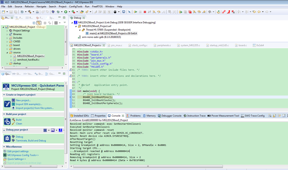

3. import my attached project to your MCUXpresso IDE.
  Then build the project, and download it with JLINK.
  Please check my debug result:
It can enter the main code.
It means the project works OK.
Please try it on your side.
Kerry
