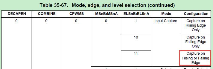

Hi Scott,
K10 FlexTimer module input capture can occur on rising edges, falling edges or both edges.
More detailed info, please check below configuration how to set input capture with both edges:
Wish it helps.

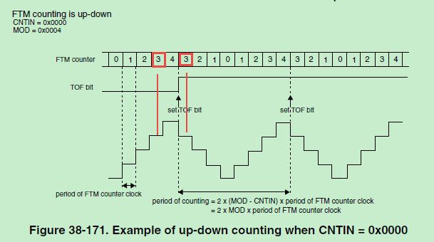

ScottKerstein
Hi Ma,
I am sorry, I wasn't clear in the beginning.  The question has to do with the PWM and center align count mode.  For center align, the counter counts up and then down.  The datasheet states you can not assign an INPUT capture to this type of counter, but It really isn’t clear.  Is this true?
Thanks.
1,902 Views
Hui_Ma
Hi Scott,
If the counter is up-down counting, the input capture function can not work at this counter mode.
From below picture, if the counter is 3, you could not know when the input capture happens.
