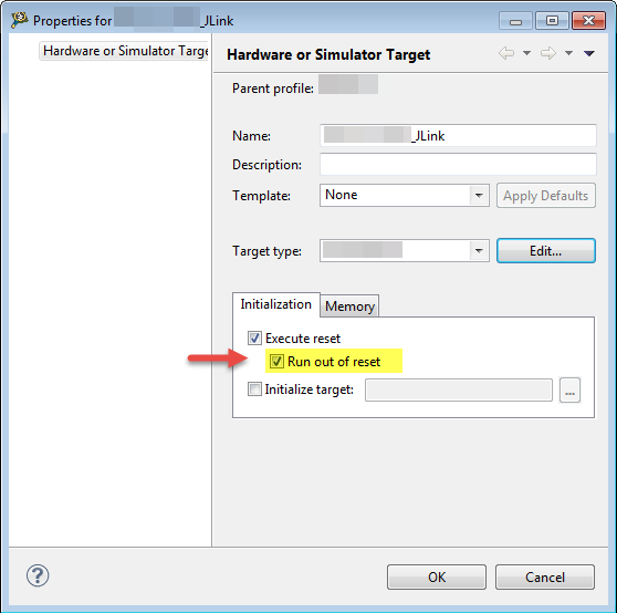

I guess I understood your issue now. The K10 resets as expected but you want the debugger to continue running, correct? The K10 is not freezing, instead the debugger is taking control of the CPU again and halting it when the reset occurs.
After some tests I found that the ability to restore connection and continue the debug session depends on the debug probe and also in the connection settings of CodeWarrior. It worked for me using J-Link but not with P&E tools (Multilink Universal or OSBDM).
If you have a J-Link and want to try, go to Run -> Debug Configurations -> Select the connection and click on "Edit" -> Target -> Edit again and from the Initialization tab check the option "Run out of reset", as in the next picture:
