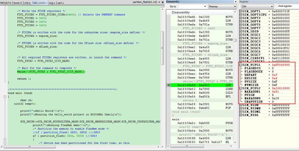

I had done a test with TWR-K20D72M board, which with PK20DX256VLL7 mask set 1N36B mounted.
After I using the J-Link tool unlock (external mass erase) the K20 chip, the reset value of SIM_FCFG1 register value as below picture shows:
As your mentioned, the SIM_FCFG1 register [EESIZE] value is 0x3.
In fact, The EEPROM default value 0x3 does not affect the Flash Program Partition Command operation.
I had done the test to validate it works.
The SIM_FCFG1 & SIM_FCFG2 registers value will be modified during Flash Program Partition Command execution.
I debug the code and find those registers value changed as below picture shows:
There does not need a reset before SIM_FCFG1 & SIM_FCFG2 registers update the value.
Sorry for my previous answer about it.

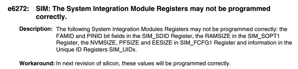

There is an errata record about SIM_FCFG1 register reset value for mask set 1N36B:
I am using the mask set 1N36B chip do the test and observed behavior was caused by this errata.
While, I don't have mask set 3N36B chip on hand.
I need to double check with Kinetis product team if this errata was fixed or not.
For, so far from mask set 3N36B errata file, this e6272 record was removed.
I will let you know when there with any feedback. Thank you for the patience.
